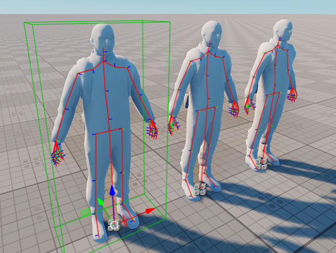

Setting Up Bones#
Bone hierarchy of your skinned mesh is displayed in the Bones section of the Parameters window.
Each bone of a skinned mesh can be bound to a separate node to control its transformation giving you a lot of flexibility. For example, you can animate these nodes via the Tracker tool or enable physics-based control over skinned mesh bones binding them to nodes driven by physics.
Visualize Bones | Enable visualizer for bones and their basis vectors to monitor your settings while adjusting them. The visualizer is rendered even when a skinned mesh is not selected in the World Nodes hierarchy, making it possible to show positions of bones for multiple meshes simultaneously.
The global Visualizer is enabled automatically, when you check this option. |
Create Dummy Hierarchy | Creates a hierarchy of dummy nodes for the skinned mesh, where each node has the same name and transform as the corresponding bone and is bound to it with default settings. The hierarchy can also be generated for selected bones only. |

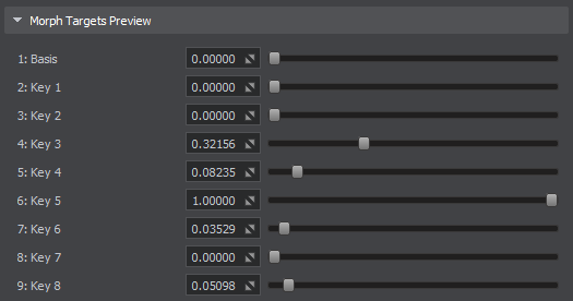

Controlling Morph Targets#
For meshes containing morph targets, the Morph Targets Preview list is available in the Parameters window. This set of parameters in the Editor allows visualizing what the model looks like with one or more morph targets applied. Actual application of morph targets and their weights is done via code.
Each target has a slider that allows configuring its weight — the extent of the morph target's effect on the resulting view of the model.
Basis represents the original position of all vertices of the mesh, and its slider is shown for reference.
