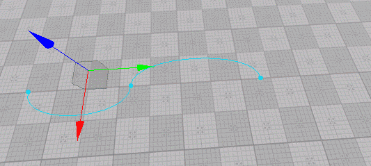

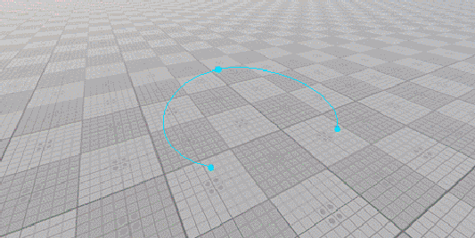

A spline graph is determined by a set of points p0, p1, ... pn and a set of edges or segments (cubic Bezier splines), that connect some or all of these points.
Each segment is determined by a starting (pSTART) and an ending (pEND) point, as well as tangent vector coordinates at these points, which determine the curvature of the segment (tSTART and tEND respectively). Points, that are shared by more than two segments are called junctions.

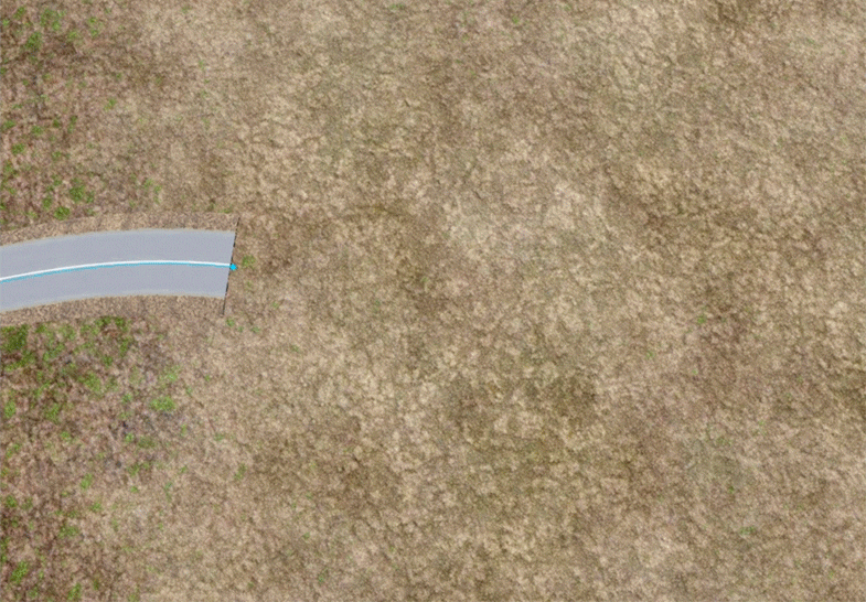

Coordinates of the UP vector are additionally stored for each point of the segment. This vector is used to define orientation of nodes placed along the segments of the spline graph. By default this vector is parallel to the Z axis. The UP vector does not affect the curvature of the spline segment itself.
UP vector adjustment.

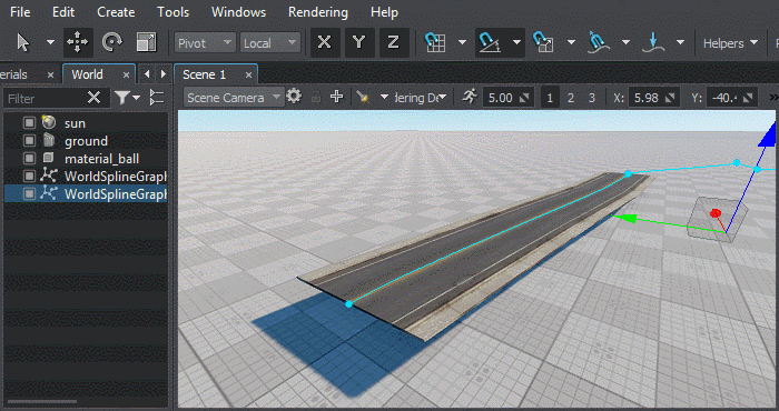

SDK includes the Road Tool Constructor add-on with a set of ready-to-use assets (road segments and various types of junctions) that can be used as construction elements to simplify roads creation.

    • world_spline_graph/roads - roads created on the terrain surface

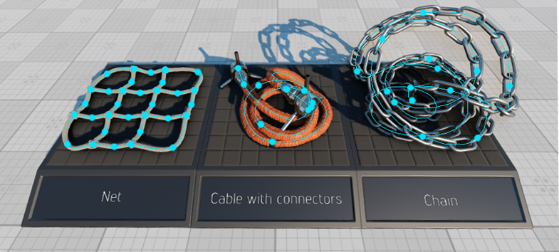

    • world_spline_graph/ropes - ropes, chains, and cables

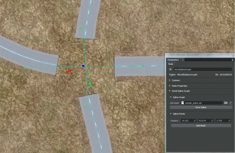

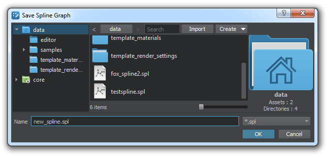

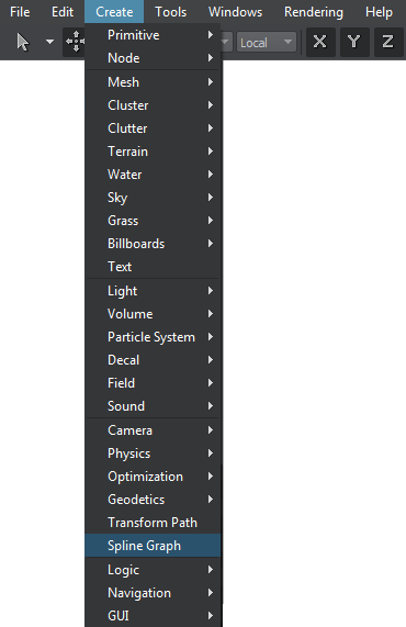

To create a new World Spline Graph, do the following:
  2. Specify a name of existing spline file (*.spl) to be used for the new World Spline Graph or a new name to create your spline from scratch.
  3. Edit the spline graph by managing its points and segments.
  4. Assign desired source nodes to points and segments of the spline graph.

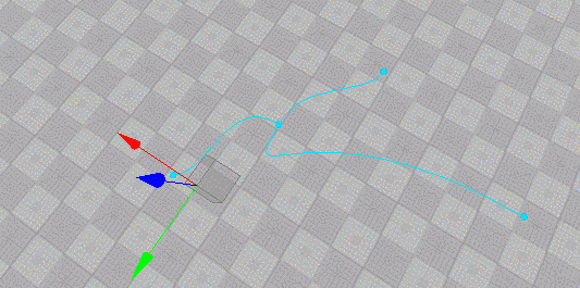

Adding a New Point#

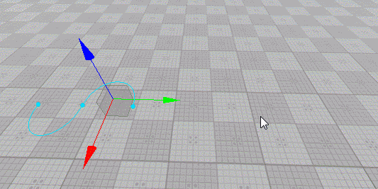

New points are added to the spline graph by cloninng existing ones. To add a new point do the following:
  1. Select the World Spline Graph.
  2. Select the desired point, which you wish to clone (Move manipulator will appear).
  3. Press Ctrl + D on the keyboard (a new point will be created).
  4. Use the Move manipulator to position you new created point.

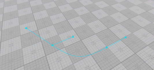

Tangents control the curvature of the spline segment. To adjust tangent at a point do the following:
  2. Select the desired point (Move manipulator will appear).
  3. Select the desired tangent (in case the selected point is shared by multiple segments, several tangents will be displayed for it). As you select a tangent the Move manipulator appears next to it.
  4. Use the Move manipulator as you would do to move a node (the form of the corresponding segment will change).

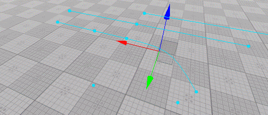

Adding a New Segment#

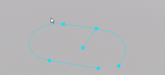

To add a new segment to the spline graph do the following:
  2. Select the starting point for the new segment to be added (Move manipulator will appear).
    • To create a straight segment, you should drag the manipulator in the direction of the tangent at the starting point.
    • The new added segment uses all settings (assigned nodes, placement modes and parameters) of the previous one.
You can also clone segment(s) by selecting them and moving with the Shift key pressed, or pressing Ctrl + D and placing the clone with the Move manipulator.

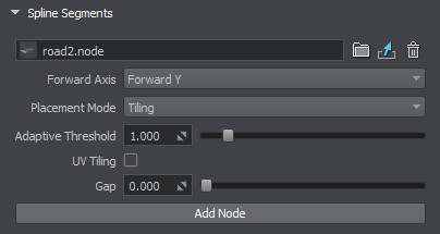

For each of the source nodes assigned to the selected segment(s) the following settings are available for adjustment via the Parameters tab:
Node Path to a *.node file containing a source node.
Forward Axis Defines which axis of the source node is to be oriented along the spline.
    This mode is the most performance-friendly.
  • Tiling - multiple instances of the source node are placed along the segment. The number of instances is determined by the sizes of the segment and the source node and the value of the Gap parameter.
  • Adaptive - a combination of the previous two resulting in multiple instances of the source node placed along the segment. Some of these instances may be stretched depending on segment's curvature.
UV Tiling Enables tiling of the source node's textures.

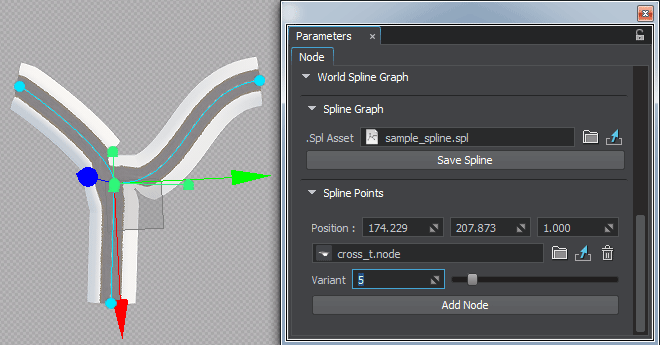

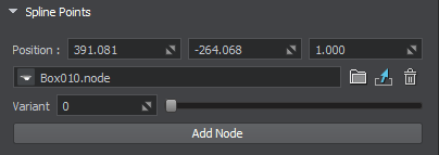

To assign a source node to selected point(s) do the following:
  • Select the desired point(s).
  • Click Add Node in the Parameters tab.
For each of the source nodes assigned to the selected point(s) the following settings are available for adjustment via the Parameters tab:

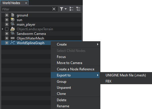

Exporting World Spline Graph#
World Spline Graph works well as a tool for object placement and deformation, but due to some technical issues, it is difficult to use it in final applications as the resulting object. Therefore, as soon as the object arrangement is final, it is required to export the spline graph to the .mesh or .fbx file.
To export World Spline Graph, right-click it in the World Nodes hierarchy, select Export to and a preferable option:
World Spline Graph Export
The export operation produces unique geometry that you can use in your projects like any other model without any additional restrictions.
