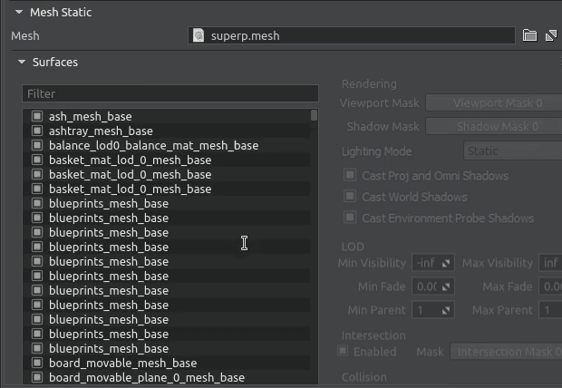

Surfaces are organized in a hierarchy that displayed in the following section:
Surfaces Hierarchy
Surfaces can be filtered by name:
Filtering Surfaces
To change the surface parameters, select the required surface in the hierarchy and tweak its parameters. For each surface, the parameters listed below are available for editing.
