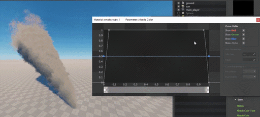

To open Curve Editor, click on the curve preview widget.
A separate Curve Editor window opens for each parameter. The previously opened windows are not closed.
