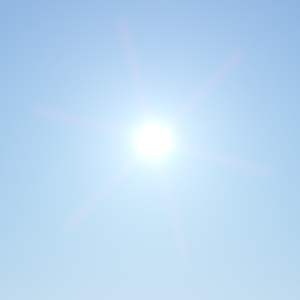

Threshold The brightness threshold, which is used to detect if an object should be blurred in the HDR mode. By the minimum value of 0, the bright areas can become overexposed.
Range of values: [0.0f, inf]. The default value is 1.0f.
Console access: render_camera_effects_threshold (API control)
Threshold = 0.6
Threshold = 1.2

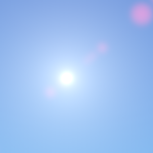

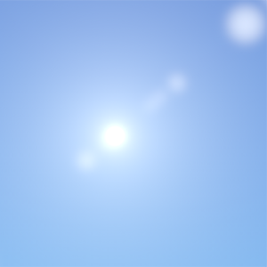

Dirt Scale The intensity of lens dirt effect modulating the pattern of lens flares defined by the Dirt Texture. For example, it can be used to create an effect of unclean optics when the camera looks at the sun.
Range of values: [0.0f, 1.0f]. The default value is 0.5f.
Console access: render_dirt_scale (API control)
Dirt
A texture that creates an effect of dirty camera lens. For example, it can be used to create an effect of light reflections or unclean optics when the camera looks at the sun.
Example of dirt texture
No dirt texture
Custom dirt texture
If you can't see any effect of the Dirt texture, try tweaking the Threshold parameter.

Cross#
Cross Settings
Enabled The value indicating if cross flares are enabled. выкл. by default.
Console access: render_cross (API control)
Color The color of the cross flares. To use this option, rendering of cross flares should be enabled.
vec4_one - default value (white)
Console access: render_cross_color (API control)
Scale The color multiplier.cross color scale — a multiplier for the color of cross flares. Higher values produce more pronounced flares. To use this option, rendering of cross flares should be enabled.
Console access: render_cross_scale (API control)
Scale = 0.4 (by default)
Scale = 0.7
Shafts The number of shafts in a cross flare. High number of flares can cause a FPS drop on low-performance hardware. To use this option, rendering of cross flares should be enabled.
Range of values: [2, 32]. The default value is 4.
Console access: render_cross_shafts (API control)
Shafts = 2 (minimum)
Shafts = 6 (by default)
Shafts = 32 (maximum)
Length The length of a cross flare relative to the screen width. Increasing this value also leads to fading of the shafts across their length. To use this option, rendering of cross flares should be enabled.
Range of values: [0.0f, 2.0f]. The default value is 0.2f.
Console access: render_cross_length (API control)
Length = 0.2 (by default)
Length = 0.4
Angle The cross flares orientation angle. To use this option, rendering of cross flares should be enabled.
Range of values: [-inf, inf]. The default value is 45.0f.
Console access: render_cross_angle (API control)
Angle = 45 (by default)
Angle = 90
Threshold The brightness threshold for areas to produce flare. The higher the threshold value, the brighter the area should be to produce a flare. To use this option, rendering of cross flares should be enabled.
Range of values: [0.0f, inf]. The default value is 0.0f.
Console access: render_cross_threshold (API control)
Lens#
Lens settings
Enabled The value indicating if lens flares are enabled. выкл. by default.
Console access: render_lens (API control)
Color The color of HDR lens flares. To use this option, rendering of lens flares should be enabled.
Console access: render_lens_color (API control)
Scale The multiplier for color of HDR lens flares. To use this option, rendering of lens flares should be enabled.
Console access: render_lens_scale (API control)
Scale = 0.25
Scale = 0.5
Length The length of the radial lens flare indicating if the whole radial lens flare is rendered on the screen or only a part of it. This option controls how lens flares pattern is distributed. To use this option, rendering of lens flares should be enabled.
Console access: render_lens_length (API control)
Radius The radius of the spherical lens flares on the screen. 1.0f corresponds to a screen-wide radius (a lens flare is not visible). To use this option, rendering of lens flares should be enabled.
Console access: render_lens_radius (API control)
Radius = 0.07
Radius = 0.1
Threshold The value of the brightness threshold for areas to produce lens flares. The higher the threshold value, the brighter the area should be to produce flares. To use this option, rendering of lens flares should be enabled.
Console access: render_lens_threshold (API control)
Red
Color displacement for the red channel of lens flares.
Red = 0.9
Red = 1
Red = 1.1
Green
Color displacement for the green channel of lens flares.
Green = 0.9
Green = 1
Green = 1.1
Blue
Color displacement for the blue channel of lens flares.
Blue = 0.9
Blue = 1
Blue = 1.1
