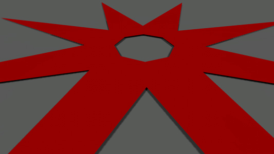

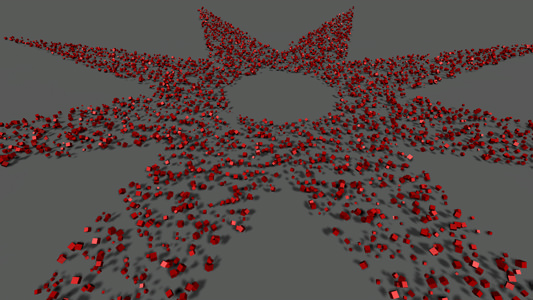

As an additional feature, masking by a mesh is also available:
Cutout by intersection with objects:
- Create Mesh Static or Decal representing a bounding cutout volume. Enable the Clutter Interaction flag for it.
- Choose and enable a bit of the Intersection mask of the object that will be used for the cutout feature.
- Enable the same bit of the Cutout Intersection mask of the Clutter object.
- Hide the visual representation of the object from the camera by disabling all bits of its Viewport mask and disabling shadow casting for it.
Cutting out trees within a box
