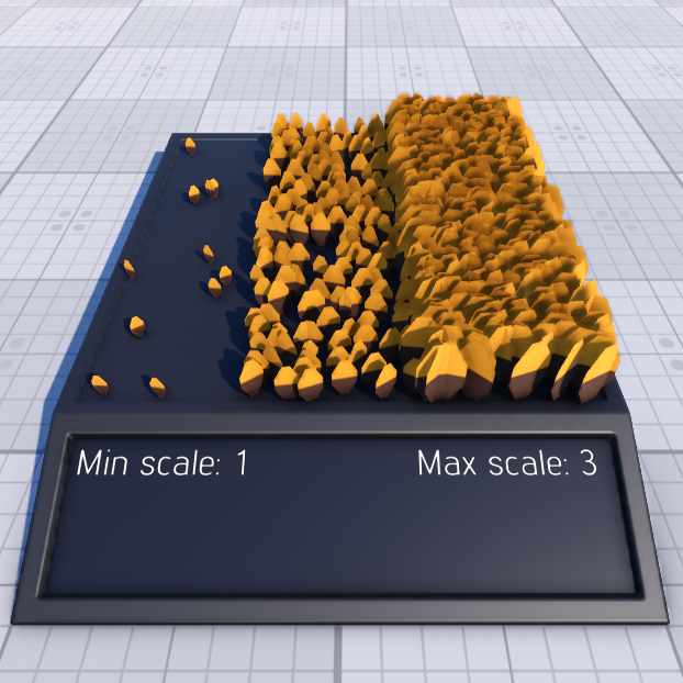

Min and Max Scale
The scale mean value of scattered objects depends on the minimum and maximum scale mean values and the image mask values: the mask values are used for linear interpolation between the minimum and maximum scale values.
  • The mean scale value cannot be negative.
Min scale Sets the scale mean value for objects scattered in the areas with low density (according to the image mask). The higher the value, the bigger the objects will be in such areas.
When image mask is not set, this parameter isn't taken into account as the default mask stores only the maximum mask values (there are no areas with low density).
Max scale Sets the scale mean value for objects scattered in the areas with high density (according to the image mask). The higher the value, the bigger the objects will be in such areas.
For example, if the following image mask is used:
The Mesh Clutter objects will be scaled as follows:
Min scale = 1; Max scale = 3
Min scale = 3; Max scale = 1

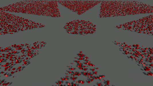

Mesh Mask A mesh-based mask can be used to place the objects. Vector masking makes it possible to create roads, rivers, etc. with extremely high precision regardless of the mask texture resolution. A mesh for masking should be a simple planar mesh.
Mesh used as a mask
Mesh-based masking
Inverse The Inverse flag toggles if the objects are placed inside or outside the mesh contour.
Inverse masking
