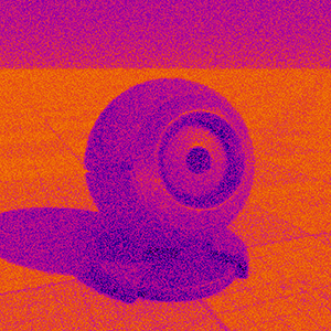

Noise Count
Noise count is a level of the color noise.
  • The lower the temperature in a specific area, the higher the color noise level will be.
Noise count = 0
Noise count = 0.3
