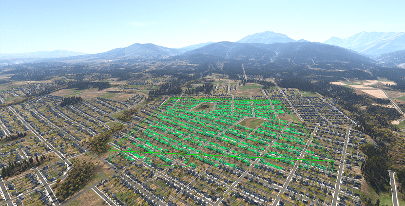

A cluster is an object that can contain a great number of identical meshes with the same material, which are managed as one object. Cluster meshes can be scattered either automatically, or each mesh can be positioned, rotated and scaled manually.
The cluster mesh is usually used for objects of the same type, for example, houses in neighborhoods.
Meshes of the cluster object that will be visible in the viewing frustum will be loaded, those ones that will not be visible will be culled. Using clusters is very efficient performance-wise: it substantially speeds up rendering and allows you to handle a lot of objects without any performance drop.

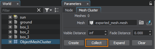

To create a cluster by baking all identical meshes in the world, do the following:
  1. On the Menu bar, click Create -> Cluster -> Mesh.
  2. In the dialog window that opens, choose the path to the .mesh file. This mesh would be used as the source one for the cluster.
  3. Place the cluster somewhere in the world. It won't be seen as it serves just like a source mesh for child meshes. Meshes that are going to be baked should have the same .mesh file as a cluster mesh.
  4. Specify the same material that is assigned to meshes going to be baked for the cluster in the Node tab of the Parameters window (the Surfaces section).
  5. Click Collect in the Mesh Cluster tab. All meshes having the same mesh and material assigned will be baked to the cluster. These meshes will no longer be seen in the nodes hierarchy.
    Parameters window, Mesh Cluster tab
