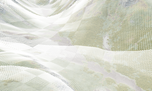

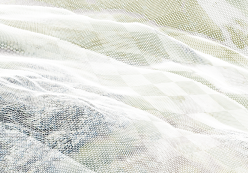

The geometry of the Landscape Terrain is split down to a number of detail levels and refined by means of adaptive hardware tessellation. The intensity of subdivision is controlled by the group of geometry parameters.
Adjust the Progression value to configure tessellation progression and levels of detail with the distance.
  • The grid density is actively changing depending on the camera's FoV. Values of FoV below 1 degree do not densify Landscape Terrain.
  • Geometry Progression is not affected by the Distance Scale value.

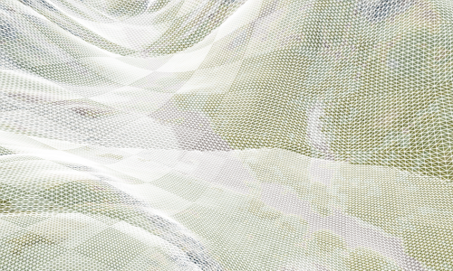

Control the density of tessellated geometry separately using the Polygon Size parameter (in comparison with the Texel Size the maximum value is used).
For optimization purposes you can increase the Subpixel Reduction value to get rid of too small polygon patches. This feature is performed on-the-fly, so make note that high values may cause slight but noticeable visual artifacts when the camera moves.

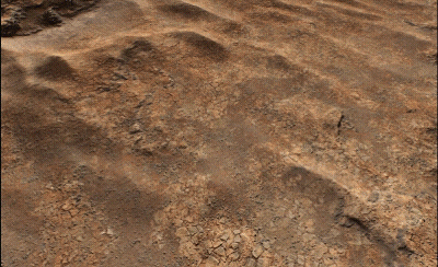

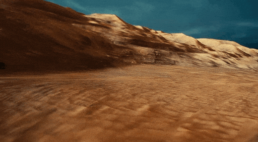

The Detail Max Height parameter enables you to set the maximum height for detail displacement. By default, it equals to 1 — the maximum possible value. In case of artifacts of stepped geometry caused by insufficient bit depth, you can adjust this parameter to a lower value, set it to the highest height value used in details. Make note that geometry will be clamped to this maximum height if details use higher values, however, normals will be affected appropriately.

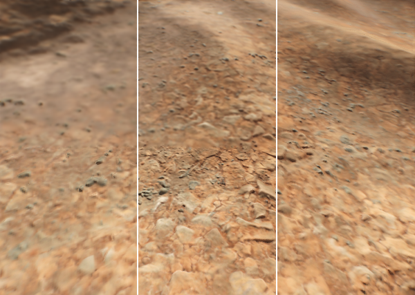

During rasterization the renderer selects the mip-level of textures according to the distance to the camera, as well as to the angle of the surface to the camera, i.e. the screen size of the polygon: distant polygons and polygons that are not faced right to the camera are rendered at a lower quality. The Texture Filtering mode controls the way of treating such situations, it has the following presets:
  • Low — use the lower mip-level. This option has the best performance but low quality: there is a noticeable edge of mip-levels change.
  • Medium — use the higher mip-level. Though the quality is better, the edge still remains. This option has a moderate effect on the performance.
  • High — linearly interpolate adjacent mip-levels. This option uses appropriate mip-levels and interpolates pixels, so the edge between mip-levels disappears. This is the most performance-consuming mode.
Comparison of filtering modes: Low, Medium, High. Settings were degraded for obviousness.
The Low and Medium modes may provide slight flickering due to low filtering quality. Use TAA to get rid of perceptible artifacts. If your project requires TAA to be disabled, try decreasing overall detail quality.

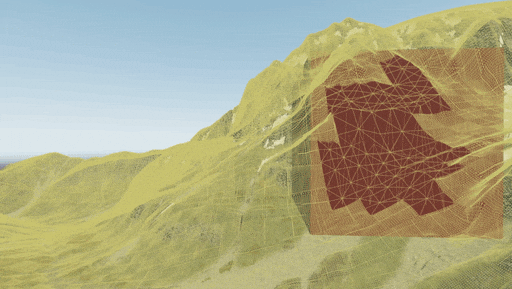

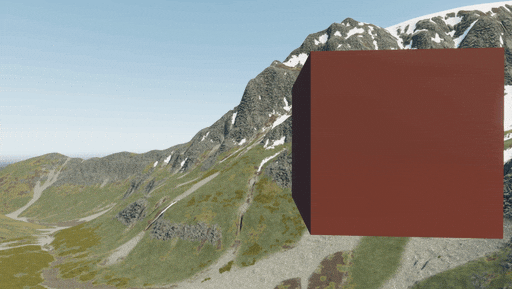

Only visible Landscape Layers are taken into account when streaming graphic data. Thus, a Landscape Layer Map with a higher Order value would overlap other ones and take part in data streaming, provided there is no blending between layers.
A schematic representation of several Landscape Layer Maps overlapping each other.
The one with the higher Order value will overlap the other ones and its data will be loaded.
Streaming is based on using previously loaded geometry to define the visible areas of terrain. The Culling flag of Landscape Layer Map enables uploading preliminary low-level data of the map to CPU (about 2 meters per pixel) to be used for checking what tiles are to be streamed next. For maps with the Culling option disabled, only high-detail data of the base map is uploaded on CPU, provided there is data loaded in the visible area.
Best Practice
Disable the Culling flag for Landscape Layer Maps that contain high-detail graphic data (having an insignificant difference in height from the base low-detail layer, e.g. centimeters, like vehicle tire tracks) and are used as insets (placed within the bounds of another layer map to provide a higher level of detail) to exclude them from loading preliminary low-level data and reduce load on CPU.
For Landscape Layer Maps that form basic shape of the landscape keep the Culling flag enabled, otherwise no graphic data will be loaded.

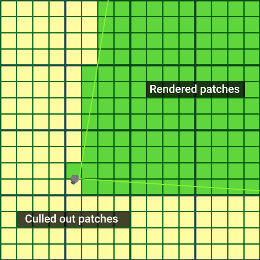

The polygons of Landscape Terrain are subject to frustum culling optimization. If a polygon falls out of the camera frustum (i.e. its screen position is outside the viewport bounds), it is culled out for rendering. You can enable the Aggressive Frustum Culling mode that implies more strict requirements for polygons to be rendered thereby increasing performance. In case of any issues with polygons rendering, try disabling this option (however, note that performance may drop).
Increase the Culling Oblique Frustum multiplier to cull out more polygons beyond the oblique frustum plane.

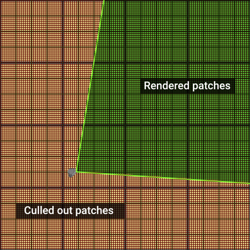

  1. CPU Culling Patches — initial patches (tiles) tested for occlusion and visibility on the CPU side. Among other culling techniques, these patches support occlusion culling by Occluders.
    Occluders support.
    The CPU patches are to be subdivided and passed to the next stage — GPU Patches. The Culling Patch Resolution CPU value defines the number of subdivisions for CPU patches:
    • The lowest value of 2 corresponds to no subdivisions at all, i.e. all patches will be culled on the CPU side. Stick with lower values if you intend to use Occluders for polygon reduction.
    • Higher values reduce the load on CPU as more patches will be checked for visibility on the GPU side.

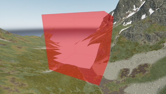

Asynchronous nature of the Landscape Terrain system makes it possible to modify the landscape surface at run time: vehicles leaving tracks while moving, procedural pit holes or even an excavator digging trenches are easy to simulate by using a separate Landscape Layer Map.
It is crucial to understand that operating a Landscape Layer Map is not the same as operating a mesh or another familiar type of object. If any of the events listed below occurs, it causes the affected tiles of the Landscape Terrain to be reloaded with the changes taken into account:
Loading of tiles data is time-sliced and not performed momentarily, neither is reloading of data. Thus, when making any changes to the set of Landscape Layer Maps in the world, it is necessary to minimize the number of modifications. As an example, you can substitute a crater with a decal or a mesh to hide the moment when the crater abruptly appears.
Control the number of reloaded tiles per each frame via the Tiles Reload Per Frame parameter, in all cases described above it might be worth increasing this value for better performance. You may also need to increase the GPU Cache Update Limit and the GPU Cache Life Time for better performance.
