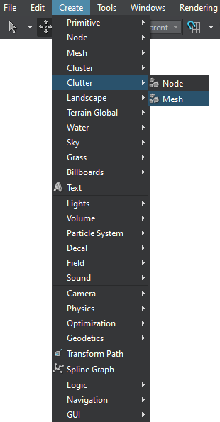

To randomly scatter a significant number of identical meshes across the terrain, Mesh Clutter is used. Mesh Clutter scatters objects procedurally and renders only those objects which are in the viewing frustum. The typical workflow is as follows:
  1. Click Create -> Clutter -> Mesh and specify the .mesh asset to be used as the source mesh for the Mesh Clutter. Click within the viewport to place the new node in the world.
    .fbx assets are containers for .mesh assets, right-click on the asset and choose Open or double-click on it to access its content.

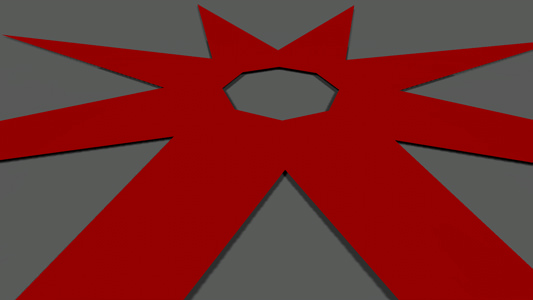

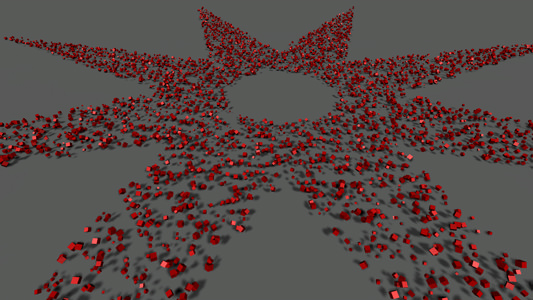

    • As an additional feature, masking by a mesh is also available:
    • Cutout by intersection with objects:
      1. Create Mesh Static or Decal representing a bounding cutout volume. Enable the Clutter Interaction flag for it.
      2. Choose and enable a bit of the Intersection mask of the object that will be used for the cutout feature.
      3. Enable the same bit of the Cutout Intersection mask of the Clutter object.
      4. Hide the visual representation of the object from the camera by disabling all bits of its Viewport mask and disabling shadow casting for it.
      Cutting out trees within a box
