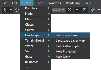

Creating a Terrain#
To create a Landscape Terrain in UnigineEditor perform the following actions:
  1. In the Create menu, select Landscape -> Landscape Terrain. Click somewhere in the Editor Viewport to add the terrain.
    Landscape Terrain is created with a Landscape Layer Map as a child.
  2. Set up Height, Albedo and Masks data for the Landscape Layer Map(s), adjust via Brush Editor.
  3. To add another layer (an inset), click Create -> Landscape -> Landscape Layer Map.

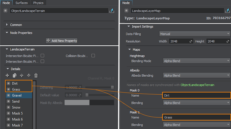

To preview a landscape mask, go to Helpers -> Landscape Masks and choose the desired mask. Also, you can use the render_show_landscape_mask N console command, where N is the index of a mask from 1 to 20.
Masks are named for convenience, names of masks are synchronized with the ObjectLandscapeTerrain currently used. You can rename each mask via both the ObjectLandscapeTerrain parameters (by double-clicking the mask title and typing a new name) and the LandscapeLayerMap parameters in the corresponding Name fields with no reimport required.
Names of masks are synchronized with ObjectLandscapeTerrain.
Select a mask to see its parameters:
Dithering Dither amount enabling you to reduce graphical artefacts caused by insufficient mask's bit depth or increased Mask Contrast value set per-detail. This Dither amount is multiplied by the global dithering amount.
Default Value Default value of the mask enabling you to skip import of single-color masks (e.g., a full white texture), thus lightening streaming load.
Mask by Albedo Select an albedo color of Landscape Layer Maps to be used as an additional filter for the mask.
Control opacity by using the Alpha channel of the Mask by Albedo color.
Names of masks are stored by Landscape Terrain objects, i.e. names shown in the parameters of a Landscape Layer Map will change in correspondence with the current enabled Landscape Terrain.

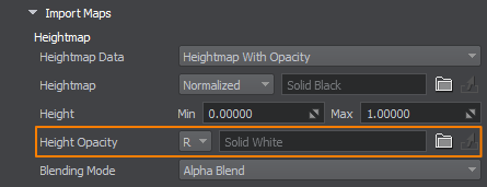

Additionally, it is possible to paint the opacity mask for each terrain component using the Brush Editor or specify it for each texture (provided the Data Filling mode is set to From Tileset). For this purpose, specify a texture and its channel to be treated as the opacity mask for the corresponding texture:
The order of blended layers matters, use the higher Order value for layer maps that should be on top.
Opacity of Landscape Layer Maps that have no underlying layers (i.e. their Order is the lowest) is ignored.

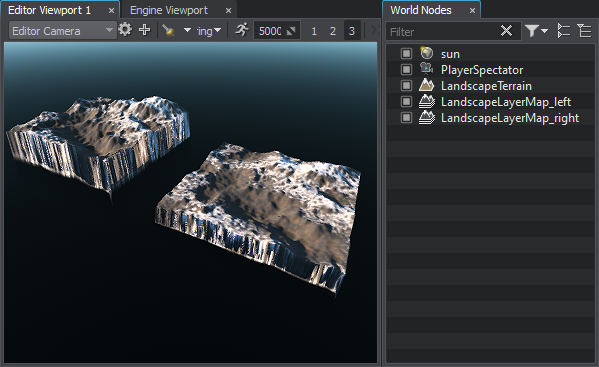

Collaborative Editing#
Blending of separate layer maps makes the Landscape Terrain system friendly for collaborative editing. A team of 3D artists can design separate layer maps simultaneously and develop a large landscape piece by piece without conflicts.
Combined with UNIGINE features for cooperative development (e.g. Node Layer, Node Reference), the system enables multiple artists to develop separate areas and layers of landscape of virtually any complexity simultaneously.
To prepare a world with a Landscape Terrain for collaborative editing via a VCS, follow this workflow:
  1. Prepare node layers:
    1. Create a new Node Layer for each Landscape Layer Map representing a static area of the landscape. For convenience, it is recommended to reset transformation of each Node Layer.
    2. Make each Landscape Layer Map a child to the corresponding Node Layer.
  2. After changing the content or parameters of any Landscape Layer Map, it only needs to save the parent node layer and commit the changed *.node asset and resources via your version control system.
  3. Upon checkout and world reloading, the changes will be applied and visible on workstations of other team members.
  4. Dynamic and repetitive Landscape Layer Maps (such as craters or chunks of tracks) can be saved as Node References.

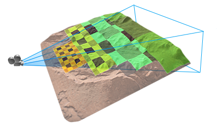

A scene may contain thousands of Landscape Layer Maps, so the full-size graphic data of the Landscape Terrain may be too large to fit in the video memory in its entirety. Instead all resources are decomposed into smaller rectangular sections — tiles of variable density depending on the distance to the camera.
Individual tiles are asynchronously loaded into the main virtual texture when necessary — only if currently seen by the camera — from the lowest to the highest available MIP-level. All tiles have the fixed resolution in video memory - 128×128 px.
Unoptimized streaming settings cause noticeable loading of tiles when the camera moves.

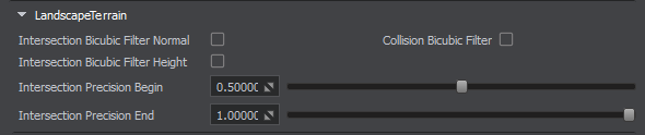

Intersections are detected with a variable precision, starting from a lower value and ending up with a higher one.
Normally there's no need to modify these values. In case of intersection detection errors you can open Landscape Terrain parameters and try tweaking start and end precision values and enable cubic filtering of textures for optimum balance, but be careful as it may significantly affect performance and accuracy:
Collision Bicubic Filter Enables bicubic filtering of textures for collision detection.
Intersection Bicubic Filter Normal Enables bicubic filtering of the normal texture for intersection detection.
Intersection Bicubic Filter Height Enables bicubic filtering of the height texture for intersection detection.
Intersection Precision Begin Starting precision of intersection detection.
Intersection Precision End Ending precision of intersection detection.

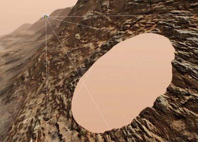

Decal-Based Holes#
In some cases you may need to cut out an area of the terrain surface. For this purpose the Decal-Based Holes feature is supported by Landscape Terrain.
Make sure the Holes feature is enabled and place any decal (orthographic, projected or a mesh one) with the decal_terrain_hole_base material assigned over the desired location:
  1. In the Create menu, select Landscape -> Hole Projected (or another one). Click in the Editor Viewport to add the decal.
  2. Adjust the transform and material parameters of the decal.
This will create a hole in the Landscape Terrain surface.
A decal-based hole with a circle mask applied.
Accurate intersection with decal-based terrain holes is supported, enabling collision detection as well as all corresponding Editor features such as selection, snapping to surface, etc.

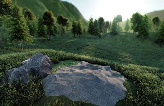

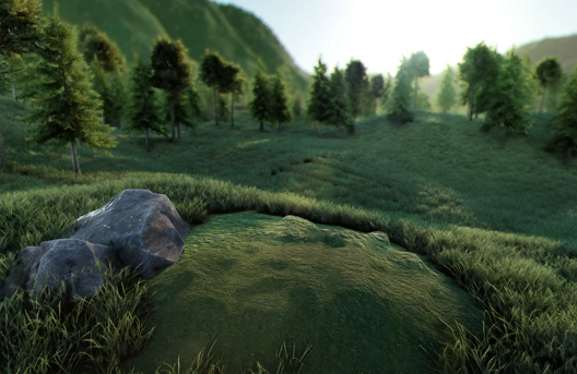

Integration of static meshes into the landscape is simpler with the use of Terrain Lerp feature.
Enabled Terrain Lerp state of the mesh_base material marks an object to be covered by projected textures of the Landscape Terrain what makes it unnecessary to set up materials for its surfaces.
The feature is suitable for creating any insets such as caves and tunnels through mountains on the terrain. As an example, on the picture below a tunnel is integrated by just cutting some area of the terrain with a decal and replacing it with a mesh with the Terrain Lerp parameter enabled.
A mesh integrated in a terrain with the Terrain Lerp enabled.
