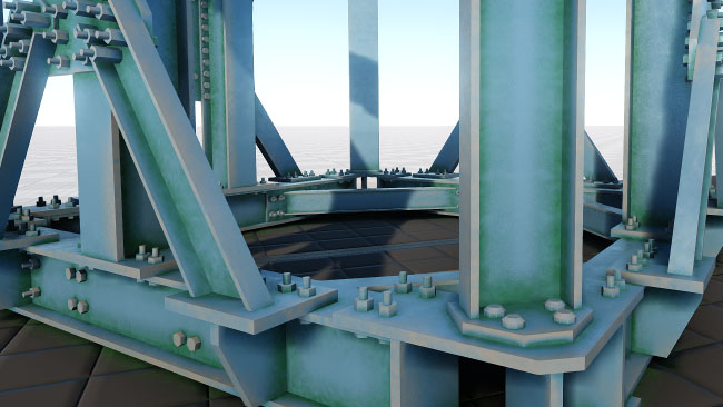

This section contains settings that control the Screen-Space Dirt effect.本节包含控制Screen-Space Dirt效果的设置。
Various slits and cavities are prone to accumulating dirt and dust, while edges tend to wear, scratch and change their initial color, usually this is simulated using so-called curvature maps prepared for each model.各种缝隙和空腔易于积聚灰尘,而边缘容易磨损,刮擦并改变其初始颜色,通常使用为每个模型准备的所谓曲率图进行模拟。
Using this effect allows you to perform curvature mapping (simulate worn scratched edges and accumulation of dirt and dust in cavities) in the screen space for all objects globally. It saves time for large complex scenes with a lot of various models and elements making them look more natural without having to prepare textures for each of them individually.使用此效果,可以在屏幕空间中为全局所有对象执行曲率映射(模拟磨损的刮擦边缘以及空腔中灰尘的积聚)。通过使用各种模型和元素,它可以为大型复杂场景节省时间,从而使它们看起来更自然,而不必为每个场景单独准备纹理。
