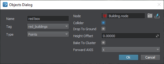

In the Objects window, click Add to add the object that will be generated on the landscape based on the vector data specified for it. The dialog window will open:
Set the following object parameters:
Name The object's name, which is displayed in the Objects list in Sandworm and in World Nodes when the landscape is generated.
Tag The tag for the selected object from the list of created tags.
Type Type of the vector object to be generated. In this case, we are generating Points.
Node The path to the basic object's *.node file.
Collider Flag indicating if collisions for the generated object are to be detected.
Available only for geometry type.
Drop To Ground Flag indicating if the generated object will be aligned with the landscape surface.
Height Offset Distance from the landscape surface along the Z axis, in units.
If you see the generated object partially, You can try to increase this value to lift it above the terrain surface.
Bake To Cluster If enabled, bakes generated point objects to Mesh Cluster. If disabled, generated objects are added to the world hierarchy as NodeReferences.
Forward Axis Axis which determines orientation of the basic object: X, -X, Y, -Y.
Split Billboards Length (km) This parameter is required if your basic object is a billboard in order to control the number of Billboards objects to be generated due to area splitting:
  • Low values will increase the number of generated Billboards objects
  • High values will reduce this number
The maximum number of billboards contained in a single Billboards object is limited to 8000. Thus, the number of generated Billboards objects is also affected by the total number of points, where the billboards are to be placed. Although billboards are performance-friendly, generating too many of them may reduce performance.
