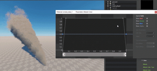

To open Curve Editor, click on the curve preview widget.要打开“曲线编辑器”,请单击“曲线预览”小部件。
A separate Curve Editor window opens for each parameter. The previously opened windows are not closed.每个参数将打开一个单独的Curve Editor窗口。先前打开的窗口未关闭。

The horizontal axis represents the input value, such as life time. The values are normalized and depend on the Life Time value of the node.横轴表示输入值,例如寿命。这些值已标准化,并取决于节点的生存时间值。
The vertical axis represents the range of available parameter values. The scale is controlled by Max Value.垂直轴表示可用参数值的范围。比例尺由Max Value控制。
The curve view can be zoomed in and out by using the scroll wheel.使用滚轮可以放大缩小曲线视图。
The curve view can be panned by dragging mouse while holding the middle button pressed or holding the Ctrl button and using the cursor keys.按住中间按钮或按住Ctrl按钮并使用光标键,同时拖动鼠标可以平移曲线视图。
If a parameter is adjusted via multiple curves, you can hide some of them via the corresponding checkboxes with color coding.如果参数是通过多条曲线调整的,则可以通过相应的带有颜色编码的复选框隐藏
