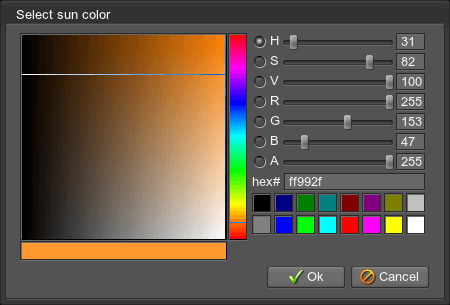

  2. Click on the Color field to change the light color used to illuminate objects in the world. Set the color values as shown at the picture:
    Click Ok to close the dialog window.

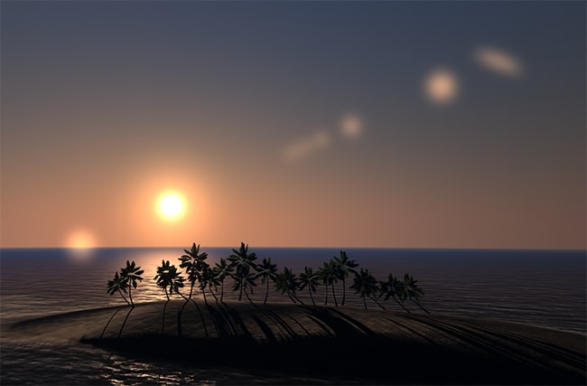

    What we've got for now is:
  2. Go to the Render -> Scaterring tab and decrease Sun value to 2.

  10. We've got a satisfying image on the open space. But we also need to put the camera is in shadows and check if the scene becomes awfully overexposed. If it is, the scene will look like:
    To darken overexposed areas, set Min luminance to -1.2. This parameter specifies the threshold, over which the scene cannot be exposed.

    Voila, the sunset sky with clouds is ready.
