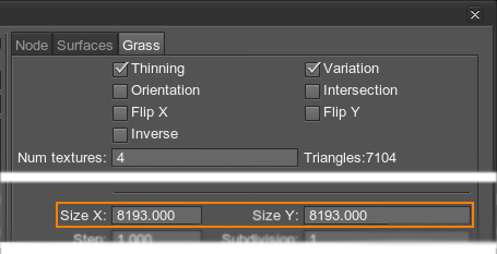

  5. Set the real size of the grass field: go to the Grass tab and set Size X (along the X axis) and Size Y (along the Y axis) to repeat the size of the8193 × 8193 terrain.
    In the result, you will see that the grass polygons appear and fade out within the set distance (94 units).
