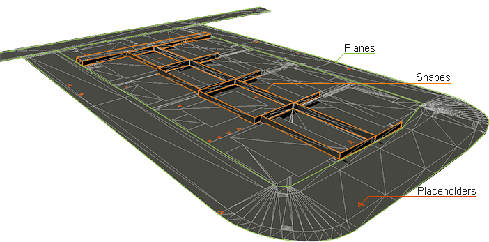

As an output data from the third-party digital content creation tool tool we obtained a huge set of objects geometry:
City Geometry Obtained from the DCC tool
This set of objects geometry is not present in the world, but provides a set of rules for city parts generation. We divided geometry into 3 types, which were specified while exporting from the DCC tool:
  • Placeholders - simple one-polygon triangle surfaces. This specification is convenient for objects which will require to load additional nodes (for example buildings, trees, cars, benches). They set the coordinates for objects to be placed in. Such surfaces provide a set of rules for Cluster Layers.
  • Planes - flat multipolygon surfaces. This specification is convenient for flat surfaces which will require just a cover material to be assigned (for example roads, fields, home lawns). Such surfaces provide a set of rules for Decal Layers.
  • Shapes - surfaces forming geometric objects. This specification is convenient for surfaces that form some geometric objects and does not require to load additional nodes, only a material assigned (for example fences, billboards). Such surfaces provide a set of rules for Mesh Layers.
City Geometry Types
Surfaces are named on this stage for further convenient specification.
LOD objects placeholders are specified along with basic surfaces.
