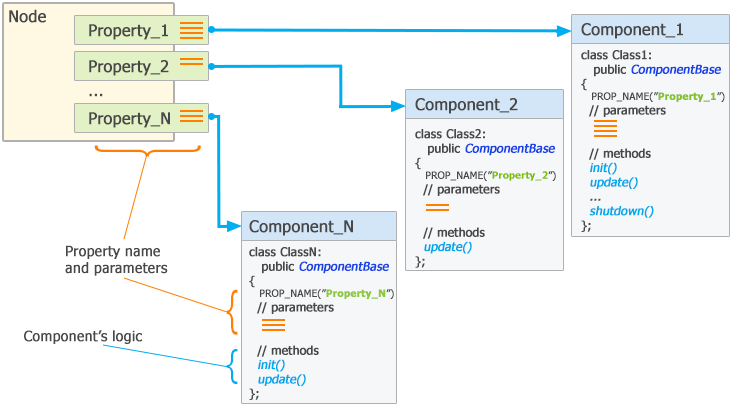

A logic component integrates a node, a C++ class, containing logic implementation (actions to be performed), and a property, defining a set of additional parameters to be used. The list of parameters as well as their types are the same for both, the component and the corresponding property.
Components assigned to a node via properties

  1. Inherit a new C++ class representing your component from the ComponentBase class.
  2. In the header file determine and declare the list of parameters to be used by this component. All of these parameters with their default values (if specified) will be stored in a dedicated property file.
  3. Implement component logic inside the certain methods (init(), update(), render(), etc.), that will be called by the corresponding functions of the Engine's main loop.
  4. Assign the created property to a node to give it the desired functionality.
Each time a property registered in the Component System is assigned to a node, an instance of the corresponding component is created. This instance will be deleted when the corresponding property is replaced with another one or removed from the node’s list, or when the node is deleted.
