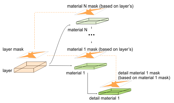

Materials are grouped into layers and use layers masks (or generate their own masks based on layers').
Detail materials have the same textures and parameters as materials, but they use "parent" materials' masks and can generate own masks, based on parents'.

    Each material uses the layer's mask (or generates it's own mask by using materialheight texture with blending parameters based on layer's mask). A detail material uses "parent" material mask (or generates it's own mask based on parent material's mask).
