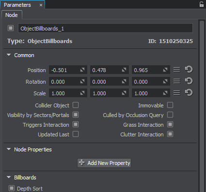

Creating Billboards#
To create the billboards, perform the following steps:
  1. On the Menu bar, click Create -> Billboards -> Base.
  2. Place the billboards object somewhere in the world.
  3. Specify the billboards parameters.
Billboards Parameters#
Depth sort Indicates that billboards should be sorted in back-to-front order according to their position. This option should be enabled, if alpha blending is used for the billboard material (except for the additive blending).
Billboards Options#
In the Billboards section of the Node tab, you can create new billboards and tweak their settings.
