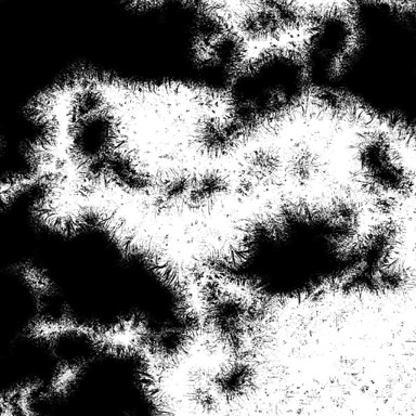

  • Mask texture (RGBA8) that determines spreading of grass across the terrain. This texture is generated based on the terrain's height map. For example, for the 8193 ×  8193 terrain, the reasonable size could be1024 ×  1024 (see details on choosing the size of the textureabove).
    Each channel of the mask (R, G, B and A) controls if the grass from the 1st, 2nd, 3rd and 4th columns (respectively) is rendered or not. The grass will grow only across areas with a channel color value.
    Within this tutorial, one mask texture will be used for both regular grass and grass of various types. So the grass from all columns of both textures will be rendered where white color is. The mask can be found in the <UNIGINE SDK Browser>/demos/valley_demo/demos/valley/masks folder.

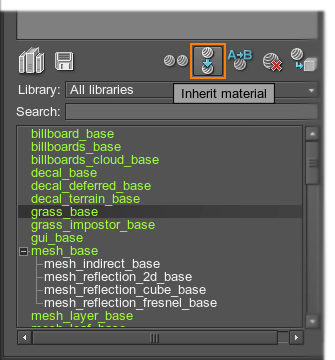

  1. On the Menu bar, choose Windows -> Materials (or press M) to open the Materials window with material settings.
  2. Select a base (and therefore unchangeable) grass_base material in the list and click Inherit material.
  3. Choose the folder where to save a new material and specify its name. The new *.mat file will be created.
  4. Select the grass_regular node and click Assign material to apply it to the selected node.
  5. Select the created grass_regular material in the list of materials and click Inherit material (see step 2 above).
    In this case, a new material will inherit all settings of the grass_regular material (e.g. slope, stem noise and so on). Anyway, you still can inherit a material for the 2nd grass object from the base grass_base material and set specific settings for it.

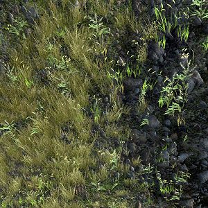

    As you can see, the grass with the diffuse textures assigned looks unnatural on the terrain: its color remains the same regardless of its location.
  11. Go to the States tab of the Materials window. Check the Color noise option for thegrass_regular material. It will allow you to color blades of the regular grass differently across the whole field. The Color noise option will also be set for the grass_variation material.
  12. For the grass_variation material, go to the States tab of the Materials window and uncheck the Color noise option. It will allow the grass of various types to differ from the regular grass.
  13. Go to the Textures tab and load the Spatial noise texture.
  14. Select path to the spatial noise texture. You can use the following texture from Valley Benchmark:
    <UNIGINE SDK Browser>/demos/valley_demo/demos/valley/textures/grass_color_d.dds
    The grass will be colored as follows:

    The grass blends with the terrain smoother and that will allow us to make a denser looking filed:
    Shadows enabled
    Shadows disabled

  3. It's time to tweak the spread of the grass. Click to load a Mask image that will specify the areas where the grass grows.
    Perform this step for both grass objects.
  4. Select a path to your mask texture, if any.
    The grass no longer grows on mountains peaks and stony areas:
    No Image Mask
    Image Mask Set for Grass
