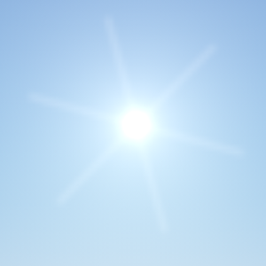

Sun Shafts
The parameters described below are available only when the light shaft effect is enabled (Rendering -> Sun Shafts).
Shaft flare around the sun
Enabled Enables sun shafts.
Color The color of light shaft.
Scale A multiplier for a color of shaft flares.
Scale = 1 (by default)
Scale = 2
Length Length of light shaft.
Length = 0.8
Length = 0.95
Attenuation How fast the flares fade out along their length:
  • By the value of 1 there is no additional attenuation.
  • The lower the value, the smaller the flare is.
Threshold Brightness threshold for sun to generate light shaft:
  • The higher the threshold value, the brighter the sun should be to generate light shaft.
