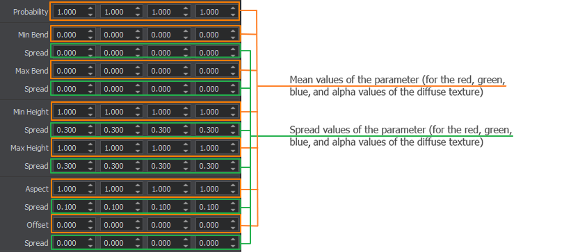

To randomize appearance of grass blades, two types of values are used:
  • Mean value (set in the main field of the parameter: Min/Max Bend, Min/Max Height, Aspect, Offset) defines the average value of distribution. Four fields correspond to the red, green, blue, and alpha channels of the diffuse texture correspondingly. Using this value, the designer can set milestones to control the parameter.
  • Spread value defines the range for possible variation of the parameter. Four fields correspond to the red, green, blue, and alpha channels of the diffuse texture correspondingly. The higher the value, the more diverse the final result is.
    The spread value is optional: if set to 0, it does not affect the simulation process. In such a case, only the mean value is uniformly used.
An example of using the Spread value is provided for the Min and Max Height parameter. It is applied similarly to the Min and Max Bend, Aspect, and Offset parameters.
Mean and spread values of the grass randomization parameters

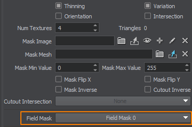

Field Mask#
Any area of a grass field can be animated by using Field Animation. Field Spacer is used to specify areas of grass that should not be rendered. Such areas of grass are specified by the Field mask (Parameters window -> Node tab -> Grass section).
The field mask set for the grass object must match the field mask of a Field node applied to the grass.
See the example on animating grass with the animation field here.
