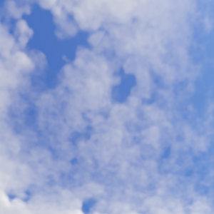

  • Layer Height — Determines the height of the cloud layer.
    Layer Height = 100
    Layer Height = 500

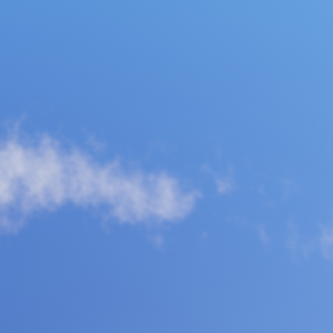

  • Coverage Size — Determines the size of the coverage texture.
    Coverage Size = 0.3
    Coverage Size = 1

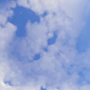

  • Coverage Contrast — This parameter determines the contrast of the coverage texture and can be used for fine tuning. It also makes it possible to gradually increase cloudiness without changing the coverage texture when simulating weather. The lower the value the more cloudy the sky looks.
    For this parameter to work properly, the coverage texture must not contain absolutely black pixels.
    Coverage Contrast = 0.3
    Coverage Contrast = 1
