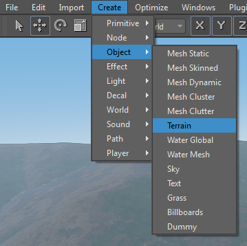

To create a new flat terrain with the specified dimensions via UnigineEditor, do the following:
  1. Run UnigineEditor.
  2. On the Menu bar, click Create -> Object -> Terrain.
  3. In the dialog window that opens, specify the parameters and choose the path to the existing .terrain file to overwrite it, or choose the path to the new terrain.
  4. Place the terrain somewhere in the world.
