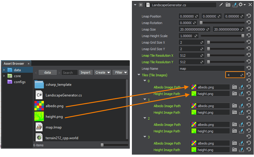

As the component is assigned, configure its settings in the Parameters window:
LandscapeGenerator component settings
Set the number of tiles in the corresponding field and drag albedo.png and height.png files to the Albedo Image Path and Height Image Path fields of the component.
Now you can launch your application via the Run button right in the UnigineEditor.
