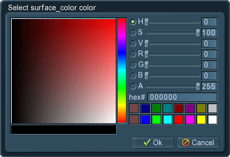

  2. Scroll up and click on the Surface Color field.
  3. Select black color so that the water surface will be transparent. Other colors can be used if creating muddy water or dense liquids like milk or oil.

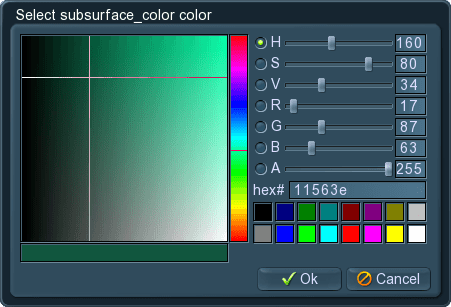

  7. Return to Parameters tab and find subsurface parameters appeared. Click on the Subsurface Color field.
  8. Select green color. In combination with blue it will bring nice turquoise tinge.
    The water surface looks like that:
