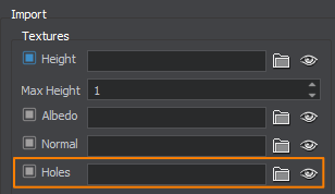

Holes Map
A holes map is a simple 1-channel texture that indicates whether there is a hole or not. Black values correspond to holes.
To import the holes map, go to the Textures field and choose the path to the holes map.
Nodes Editor, Import tab.

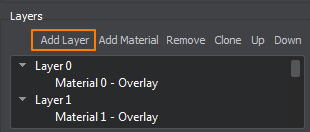

To add a layer, go to the Layers tab. Click Add and the layer will appear in the list.
At the same time, the field for this layer mask import will appear in the Import tab.

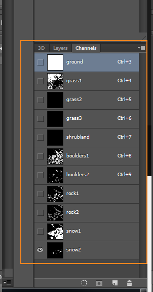

For each mask you need to specify a channel of the texture that will be used (for example, G-channel of RGBA texture). Since the texture could be a .psd file, you can specify the number of channel of the .psd file. Thus masks can be stored in single file but in different channels.
Channels in Photoshop file.
Channels in UnigineEditor.
