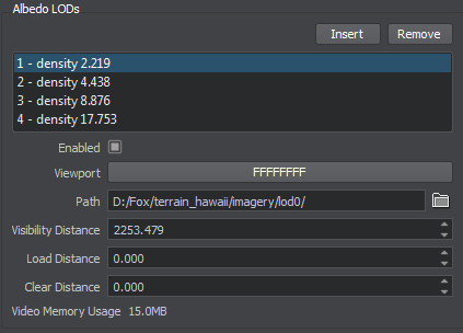

Albedo Data
Parameters of a certain LOD of the albedo data layer can be accessed via the Albedo LODs group of the TerrainGlobal tab of the Parameters window.
You can add a new LOD or remove an existing one by clicking Insert or Remove respectively.
TerrainGlobal parameters, Albedo LODs group.
The following parameters are available for the Albedo LODs:
  • Enabled - enable or disable the current albedo LOD.
  • Viewport - viewport mask for the current albedo LOD.
  • Path - path to a folder, in which the current albedo LOD is stored.
  • Visibility distance - the distance starting from which the tiles of the current albedo LOD become visible.
  • Load distance - the distance starting from which the tiles of the current albedo LOD are loaded into memory.
  • Clear distance - the distance starting from which the tiles of the current albedo LOD are removed from memory.
  • Video memory usage - memory consumption of the current albedo LOD.
