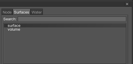

Water Surfaces
Both the global water object and the water mesh object consist of 2 surfaces approximating optical and dynamic behavior of water:

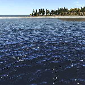

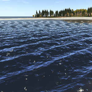

Length of the First Wave = 10
Length of the First Wave = 70

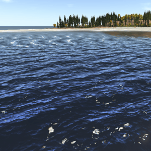

Amplitude of the First Wave = 0.3; Length = 10
Amplitude of the First Wave = 0.7; Length = 10
