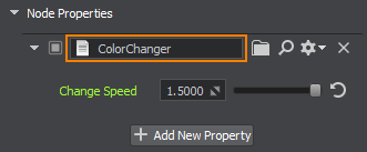

- Build and run the solution to generate a property file for the component.构建和运行的解决方案组件生成一个属性文件。
Switch back to the UnigineEditor and attach the ColorChanger property to the color zone visualization (color_zone).切换回UnigineEditor,并将ColorChanger属性附加到颜色区域可视化(color_zone)。

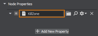

Create a new C++ component in your IDE and call it KillZone and copy the following code to the corresponding files. The trigger callback will delete any entering object. Don't forget to save your code.在您的 IDE 中创建一个新的 C++ 组件并将其命名为 KillZone 并将以下代码复制到相应的文件中。 触发器 callback 将删除任何进入的对象。 不要忘记保存您的代码。
#pragma once #include <UnigineComponentSystem.h> #include <UnigineWorlds.h> class KillZone : public Unigine::ComponentBase { public: // declare constructor and destructor for our class and define a property name. COMPONENT_DEFINE(KillZone, ComponentBase) // declare methods to be called at the corresponding stages of the execution sequence COMPONENT_INIT(init); protected: void init(); void enterCallback(Unigine::NodePtr target); private: // the area into which an object should fall Unigine::WorldTriggerPtr trigger; };
#include "KillZone.h" using namespace Unigine; REGISTER_COMPONENT(KillZone); void KillZone::init() { trigger = checked_ptr_cast<WorldTrigger>(node); // set the callback to be executed when an object enters the area if (trigger) trigger->addEnterCallback(MakeCallback(this, &KillZone::enterCallback)); } void KillZone::enterCallback(NodePtr target) { target->deleteLater(); }
- Build and run the solution to generate a property file for the component.构建并运行解决方案以生成组件的属性文件。
Switch back to UnigineEditor and add the KillZone component to the previously created World Trigger.切换回UnigineEditor并添加KillZone触发组件之前创建的世界。
