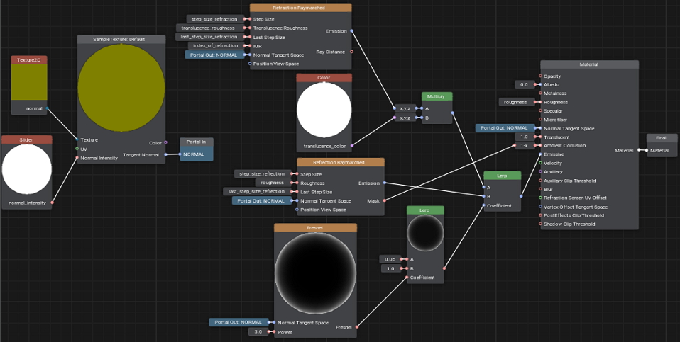

High-Quality Thick Colored Glass优质加厚彩色玻璃#
The glass_thick_colored_high_quality sample showcases an implementation of high-quality raymarched reflection and refraction for thick colored glass objects. The Fresnel node defines the mutually exclusive intensities of each component.glass_thick_colored_high_quality 示例展示了高质量raymarched的实现反射折射用于厚的彩色玻璃物体。 Fresnel 节点定义了每个组件的互斥强度。

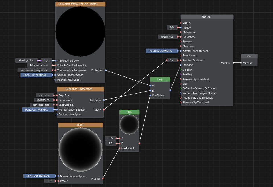

Thin Colored Glass薄彩色玻璃#
The glass_thin_colored sample showcases the use of the Refraction Simple For Thin Objects and Reflection Raymarched nodes for thin colored glass objects. The Fresnel node defines the mutually exclusive intensities of each component.glass_thin_colored 示例展示了 Refraction Simple For Thin ObjectsReflection Raymarched 节点对薄彩色玻璃对象的使用。 Fresnel 节点定义了每个组件的互斥强度。
