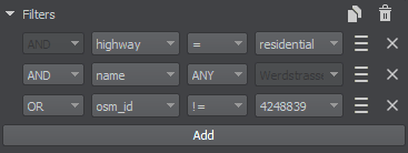

Filtering Vector Data矢量数据过滤#
Filtering of mask data is described here.这里描述了蒙版数据的过滤。
Filters are used to pick specific data from a vector source and create the required types of objects only. By default, no filters are set and all data available in the source are used to generate the specified object.过滤器用于从矢量源中选择特定的数据,并仅创建所需类型的对象。默认情况下,不设置过滤器,并且使用源中的所有可用数据来生成指定的对象。
Currently, only *.shp and *.geojson are supported as assets. Therefore, if you have other types of files, you can try to add them as External Files.目前,仅支持将 *.shp*.geojson 作为资源。 因此,如果您有其他类型的文件,您可以尝试将它们添加为 External Files
Add a vector source to set filters. As you select an already created object to modify its filters, ensure that you have selected a source in the sources list:添加一个矢量源来设置过滤器。当您选择一个已经创建的对象来修改它的过滤器时,确保您已经在源列表中选择了一个源:
Sources in this list can also be disabled and deleted. If you delete the only source, the object also will be deleted.在这个列表也可以禁用和删除。如果您删除唯一来源,对象也将被删除。
The Filter is a set of rules created using the Attributes.Filter是使用属性创建的一组规则。
Binary operation
Binary Operators
Binary operators AND and OR that allow combining several filters.二元操作符ANDOR相结合,允许多个过滤器。
Attribute name Name of the attribute available in the attribute table.属性的属性表的名称。
Attribute condition
Attribute Conditions
The available conditions are: =, !=, >, <, ANY. ANY generates all the objects that have any value assigned for the selected Attribute.可用的条件为:=, !=, >, <, ANYANY生成为所选Attribute分配了任意值的所有对象。
警告
When using > and <, make sure that the selected Attribute value type is a number. String comparison may cause issues.当使用 > 和<,确保选择的属性值类型是一个数字。 字符串比较可能会导致问题。
Attribute value Value of the attribute available in the attribute table.属性表中可用属性的值。
Attribute Table
Open Table Button
Opens the attribute table, which allows setting the Attribute Name and Attribute Value in one click. Clicking on a value fills in the corresponding fields. Double click fills in the fields and closes the table.打开属性表,允许设置属性名和属性值在一个点击。点击填写相应的字段的值。双击填充字段和关闭表。
Attributes Table
Remove filter
Remove Filter Button
Removes the corresponding filter from the list.从列表中删除相应的筛选器。
Add
Add Filter Button
Adds one more filter.添加一个过滤器。
