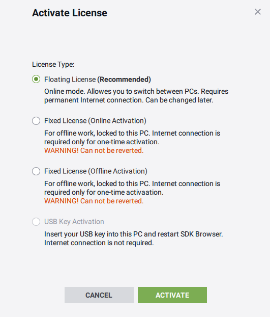

License Activation许可激活#
当你安装了一个SDK后,Activate License窗口打开:

Floating License浮动许可证#
This type of license activation is account-locked.这种类型的许可证激活附加到帐户
If you have a stable Internet connection, your licenses are retrieved automatically from your developer.unigine.com account. That means you can switch between PCs.如果您的网络连接稳定,则会从developer.unigine.com帐户中自动检索许可证。这意味着您可以在电脑之间切换。
A seat can't be used by several computers at the same time. If you sign in on a computer, you will be logged off on the one, where you've been signed in before.一个座位不能同时被多台计算机使用。如果您在计算机上登录,则将在以前登录的计算机上注销。
要使用这种激活类型激活产品,请在产品安装后立即出现的Activate License窗口中选择Floating License类型:
如果该产品已经安装,但尚未激活,请执行以下操作:
  1. Run SDK Browser and sign in with your credentials.
    运行SDK Browser并使用您的凭据登录。
  2. Go to the Products tab of the SDK Browser.转到SDK浏览器的Products选项卡。
  3. Click Activate on the SDK panel.
    SDK 面板上单击 Activate
  4. In the window that opens, choose Floating License and click Activate. SDK will be activated and locked to the current account.
    在打开的窗口中,选择Floating License,然后单击Activate。 SDK将被激活并锁定到当前帐户。
