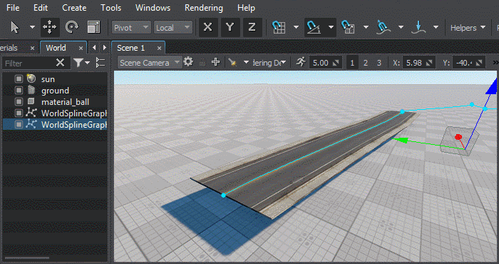

World spline graph is a convenient and performance-friendly method to place specified nodes (called source nodes) along a spline graph (its vertices and edges). It is not a single-purpose tool designed just to create roads. It can also be used for ropes, chains, pipes, and any objects, having a form that follows a curved path. It is designed to help artists quickly build various complex structures from typical basic elements placed along spatial curves, such as pipes and tubes at an oil refinery, for example. 世界样条图是一种方便且性能友好的方法,用于沿样条图(其顶点和边)放置指定的节点(称为源节点)。 这不是旨在创建道路的单一目的对象。它也可以用于绳索,链条,管道和任何物体,它们的形状遵循弯曲的路径。它旨在帮助艺术家根据沿空间曲线放置的典型基本元素(例如炼油厂的管道)快速构建各种复杂的结构。
World Spline Graph Applications世界样条图应用
The use of World Spline Graph implies the object placement and deformation and a subsequent export to .mesh and .fbx files.World Spline Graph 的使用意味着对象放置和变形以及随后导出到 .mesh.fbx 文件。
A spline graph is determined by a set of points p0, p1, ... pn and a set of edges or segments (cubic Bezier splines), that connect some or all of these points.样条图由一组点p0, p1, ... pn和一组连接某些或所有这些点的边或线段(三次贝塞尔曲线样条)确定。
Each segment is determined by a starting (pSTART) and an ending (pEND) point, as well as tangent vector coordinates at these points, which determine the curvature of the segment (tSTART and tEND respectively). Points, that are shared by more than two segments are called junctions.每个分段都由起点(pSTART)和终点(pEND)以及这些点处的切线矢量坐标确定,这些点确定分段的曲率(分别为tSTARTtEND)。由两个以上段共享的 点称为交界处
Source nodes (currently Static Mesh, Skinned Mesh, and Projected Decal) can be placed at points and along the segments of the spline graph. Each point and segment can have a single or a set of source nodes assigned. One of the following modes can be selected for each individual source node assigned to a segment:源节点(当前为Static Mesh, Skinned MeshProjected Decal)可以放置在样条图的点处或沿着样条图的线段放置。每个点和线段可以分配一个或一组源节点。可以为分配给段的每个单独的源节点选择以下模式之一:

An arbitrary number of WorldSplineGraph nodes can be added to the scene as it uses a number of optimizations (such as baking elements into large segments etc.) to ensure acceptable performance for large areas.可以将任意数量的WorldSplineGraph节点添加到场景中,因为它使用了许多优化(例如将烘焙元素分成大段等)来确保大面积的可接受性能。
Coordinates of the UP vector are additionally stored for each point of the segment. This vector is used to define orientation of nodes placed along the segments of the spline graph. By default this vector is parallel to the Z axis. The UP vector does not affect the curvature of the spline segment itself.UP矢量的坐标还针对该段的每个点存储。该向量用于定义沿着样条图的线段放置的节点的方向。默认情况下,此向量平行于Z轴。 UP向量不会影响样条曲线段本身的曲率。

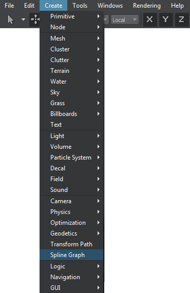

Creating a World Spline Graph创建世界样条图#
To create a new World Spline Graph, do the following:要创建一个新的World Spline Graph,请执行以下操作:
    添加一个World Spline Graph节点:在菜单栏, 选择Create -> Spline Graph
  2. Specify a name of existing spline file (*.spl) to be used for the new World Spline Graph or a new name to create your spline from scratch.
    Remember, *.world files store only WorldSplineGraph node's data (transformation, list of source nodes, etc.), while spline graphs themselves are stored in separate *.spl files. To save the spline graph that you created in the world, click Save Spline in the Parameters tab and specify a file name for it. Remember, *.world files store only WorldSplineGraph node's data (transformation, list of source nodes, etc.), while spline graphs themselves are stored in separate *.spl files. To save the spline graph that you created in the world, click Save Spline in the Parameters tab and specify a file name for it.
    指定要用于新样条文件的现有样条文件(*.spl)的名称World Spline Graph或使用新名称从头开始创建样条线。
    Remember, *.world files store only WorldSplineGraph node's data (transformation, list of source nodes, etc.), while spline graphs themselves are stored in separate *.spl files. To save the spline graph that you created in the world, click Save Spline in the Parameters tab and specify a file name for it. 请记住,*.world文件仅存储WorldSplineGraph节点的数据(转换,源节点列表等),而样条图本身存储在单独的*.spl文件中。要保存在世界上创建的样条图,请在Parameters选项卡中单击Save Spline并为其指定文件名。
  3. Edit the spline graph by managing its points and segments.通过管理样条图来编辑样条图点数
  4. Assign desired source nodes to points and segments of the spline graph.分配样条图的点和线段的所需源节点。
