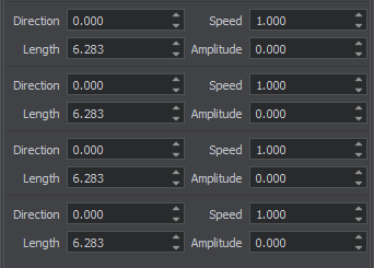

Settings of a water mesh object can be adjusted via the Parameters window:可以通过 Parameters 窗口调整 water mesh 对象的设置:
  • In the Water Mesh section, waves that determine periodic and sinusoidal nature of water can be set. Also on the Water Mesh tab, you can set a mesh to used for the water mesh object and specify a field mask.Water Mesh 部分,波浪可以设置确定水的周期性和正弦性质。同样在 Water Mesh 选项卡上,您可以设置用于 water mesh 对象的网格并指定字段掩码.

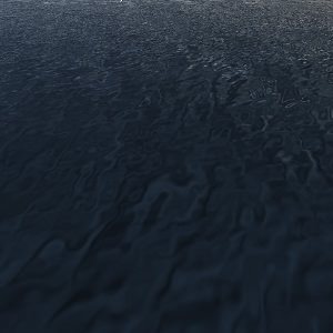

By default, water surface ripples according to the normal map (see the water_mesh_base material). However, different kinds of waves can be also simulated with 4 directional geometrical waves, summed to create dynamic waves. This model uses static geometry animated in vertex shader. Movement each of the wave is set independently that enhances flexibility of adjustment.默认情况下,水面会根据法线贴图产生波纹(参见 water_mesh_base 材质)。然而,不同种类的波也可以用4 个方向几何波模拟,相加产生动态波。该模型使用在顶点着色器中动画的静态几何体。每个波浪的运动都是独立设置的,增强了调整的灵活性。
The waves have the following characteristics defining their periodic and sinusoidal nature:波具有以下特征,定义了它们的周期性和正弦特性:
Direction A directional wave (unlike the circular one from the objects, for example) travels along the specified direction:
  • By the minimum value of 0, the wave spreads along the Y axis and is parallel to the X axis.By the minimum value of 0, the wave spreads along the Y axis and is parallel to the X axis.
  • Positive values rotate the wave about the Z axis, meaning the wave direction is slanted counterclockwise relative to its initial spread.Positive values rotate the wave about the Z axis, meaning the wave direction is slanted counterclockwise relative to its initial spread.
  • Negative values rotate the wave on the water surface clockwise.Negative values rotate the wave on the water surface clockwise.
  • By the maximum possible values of 180 or -180, the wave direction becomes parallel to the X axis yet again.By the maximum possible values of 180 or -180, the wave direction becomes parallel to the X axis yet again.
By the minimum value of 0, the wave spreads along the Y axis and is parallel to the X axis.Positive values rotate the wave about the Z axis, meaning the wave direction is slanted counterclockwise relative to its initial spread.Negative values rotate the wave on the water surface clockwise.By the maximum possible values of 180 or -180, the wave direction becomes parallel to the X axis yet again.
定向波(例如,与来自对象的圆形波不同)沿指定方向传播:
  • By the minimum value of 0, the wave spreads along the Y axis and is parallel to the X axis.通过 0 的最小值,波沿 Y 轴传播并平行于 X 轴。
  • Positive values rotate the wave about the Z axis, meaning the wave direction is slanted counterclockwise relative to its initial spread.正值使波浪绕 Z 轴旋转,这意味着波浪方向相对于其初始传播逆时针倾斜。
  • Negative values rotate the wave on the water surface clockwise.负值顺时针旋转水面上的波浪。
  • By the maximum possible values of 180 or -180, the wave direction becomes parallel to the X axis yet again.通过 180-180 的最大可能值,波方向再次变为平行于 X 轴。
Speed The wave progresses along the water surface with the definite speed (measured in units per second):
  • The minimum value of 0 means the wave is inactive.The minimum value of 0 means the wave is inactive.
  • Increasing the value results in waves following each other faster.Increasing the value results in waves following each other faster.
The minimum value of 0 means the wave is inactive.Increasing the value results in waves following each other faster.
波浪以一定的速度沿着水面前进(以每秒为单位):
  • The minimum value of 0 means the wave is inactive.最小值 0 表示波形处于非活动状态。
  • Increasing the value results in waves following each other faster.增加该值会导致波浪更快地相互跟随。
