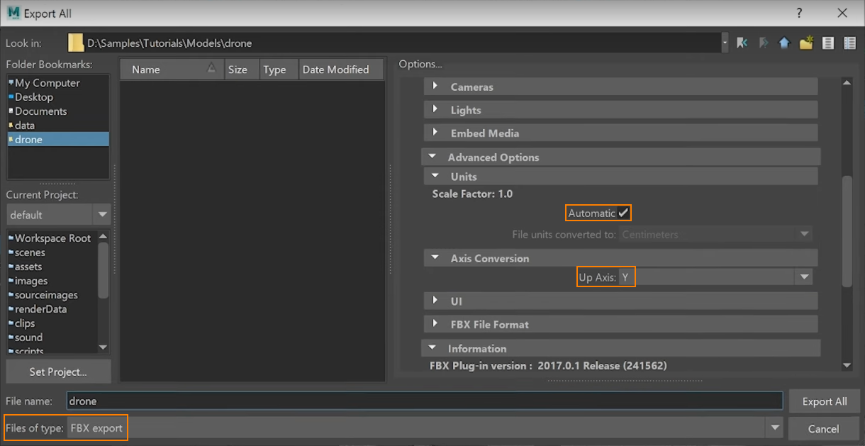

As soon as your model is ready for export, click File -> Export All....一旦准备好导出模型,请单击File -> Export All...
Export settings should be the following:导出设置应为以下内容:
  • Files of type: FBX export
  • Units: Automatic
  • Up Axis: Y
