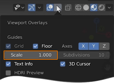

  • Check that Meters are set as working units.检查仪表是否设置为工作单位。
    Blender scale should be: 1 unit = 1 meter.Blender标度应为:1 unit = 1 meter
    For convenience, you can set the grid cell size equal to 1 meter:为了方便起见,您可以将网格像元大小设置为等于1米:
