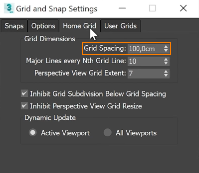

    For convenience, you can set the grid cell size equal to 1 meter:为了方便起见,您可以将网格像元大小设置为等于1米:
    Go to Tools -> Grids and Snaps -> Grid and Snap Settings -> Home Grid.转到Tools -> Grids and Snaps -> Grid and Snap Settings -> Home Grid

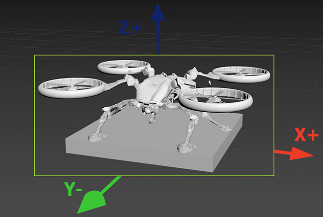

  • Orient the model towards the negative direction of the Y axis, which is the front direction in Autodesk 3ds Max.将模型朝向Y轴的负方向(即Autodesk 3ds Max中的正向)定向。
  • Set the actual model size.设置实际模型尺寸。

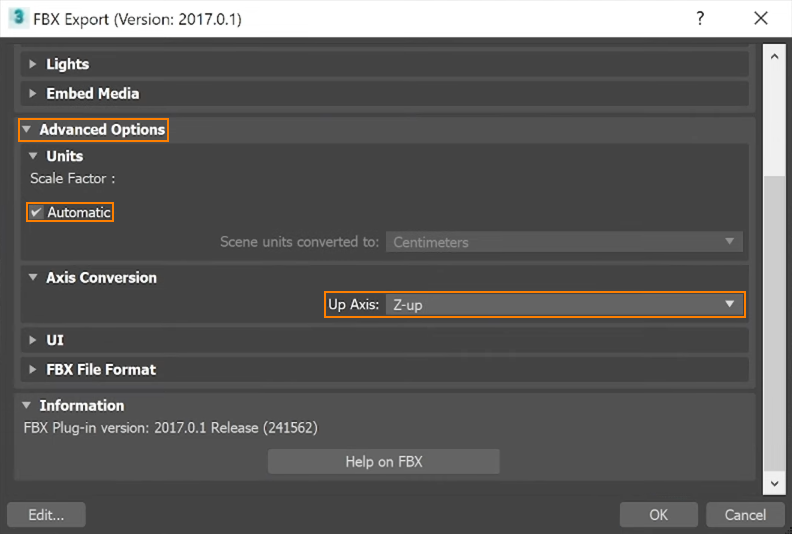

As soon as your model is ready for export, click File -> Export. Save as type: Autodesk (*.FBX), click Save.一旦准备好导出模型,请单击File -> Export。另存为:Autodesk (*.FBX),单击Save
In FBX Export window, select Geometry and enable Smoothing Groups and Triangulate.FBX Export窗口中,选择Geometry并启用Smoothing GroupsTriangulate
In the Advanced Options, enable Automatic scale factor and select Z-up as the Up Axis.Advanced Options中,启用Automatic比例因子,然后选择Z-up作为Up Axis
