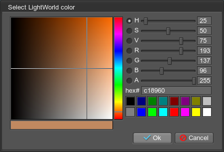

  2. Click on the Color field to change the light color used to illuminate objects in the world. Set the color values as shown at the picture:
    Click Ok to close the dialog window.

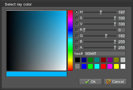

  6. Ray color for Rayleigh scattering should be more intense.

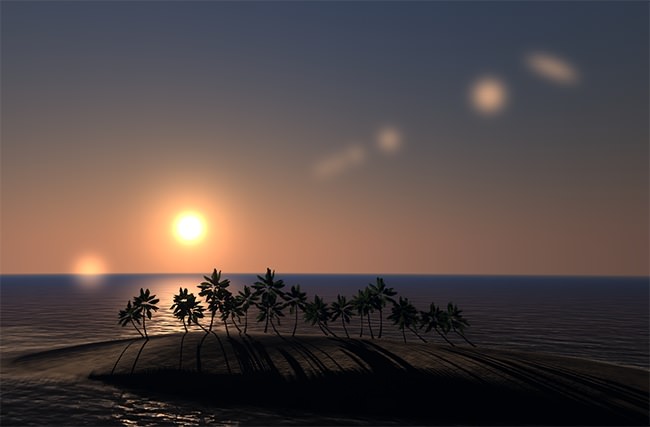

  10. We've got a satisfying image on the open space. But we also need to put the camera is in shadows and check if the scene becomes awfully overexposed. If it is, the scene will look like:
    To darken overexposed areas, set Min luminance to -1.2. This parameter specifies the threshold, over which the scene cannot be exposed.
Step 6. Add Clouds
  1. On the editor panel, click Add object button and choose Sky in the rollout.
    Clouds will appear in the sky:

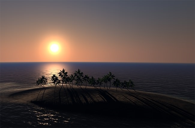

  22. However, the clouds turn out to be uniformly thick, which looks dull. Adjust the strength of layers masking with Threshold parameters:
    • Increase Threshold 01 to 1.5, making the Cloud 01 thinner.
    • Decrease Threshold 23 to 0.4, making the Cloud 23 more prominent.
    Voila, the sunset sky with clouds is ready.
