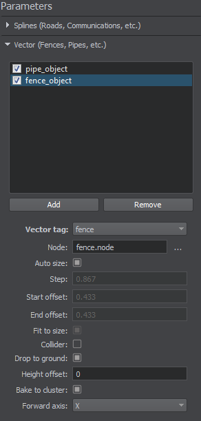

  1. On the Sources panel, select the Vector data source type and the following settings will be displayed in the Vector tab of the Parameters panel.
  2. Add a basic object for generation by clicking Add button on the Parameters panel and specify object's name. You can add as many objects as necessary.
  3. For each basic object specify the following parameters:
    Vector tag The tag to be used for the selected basic object from the list of the tags specified at the second step.
    Node The path to the basic object's *.node file.
    Auto size Enables or disables autosize mode for node placement. When this mode is enabled, basic objects are placed with zero-spacing so that bounding boxes of the first and the last basic objects are aligned with start and end points of the line segment respectively.
    Step Distance between two adjacent basic objects, in units.
    Available only when autosize mode is disabled.
    Start offset Offset of the first basic object's pivot from the start point of the line segment, in units.
    End offset Offset of the last basic object's pivot from the end point of the line segment, in units.
    Fit to size Enables stretching/shrinking of basic objects so that they are placed along line segments without spaces between them.
    Collider Flag indicating if collisions for the generated object are to be detected.
    Available only for geometry type.
    Drop to ground Flag indicating if the generated object will be aligned with the terrain surface.
    Height offset Distance from the terrain surface along the Z-axis, in units.
    If you see the generated object partially, You can try to increase this value to lift it above the terrain surface.
    Bake to cluster Flag indicating if the generated objects will be baked to a MeshCluster.
    The option is available only when the specified *.node file contains a static mesh.
    Baking to a MeshCluster shouldn't be used for large areas because of the coordinates precision limitations.
    Forward axis Axis along which the basic object is to be tiled: X, -X, Y, -Y.
  4. Check the basic objects you added at the previous step to be generated.
    If you are going to update some of the existing vector objects, check only the changed ones. At that, the other objects will remain the same after terrain generation.
  5. Now all necessary basic objects are specified and bound to tags.
    If the terrain is already generated and you want to add only vector objects - proceed to Step 4.
    Otherwise - return back to setting other parameters of terrain generation.
