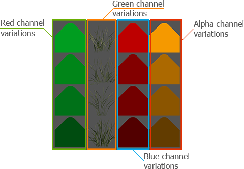

Mask RGBA8: each channel controls the distribution of the chunks in the vertical column of the grass diffuse texture.
  • Red channel specifies the areas of growth for the 1st texture column.
  • Green — for the 2nd texture column.
  • Blue — for the 3rd texture column.
  • Alpha — for the 4th texture column.
In case R8, RG8 or RGB8 texture is used as a mask, only the first, the first two or the first three columns of diffuse texture will be displayed. So, if your diffuse texture contains, for example, only 1 vertical column, the R8 texture will be enough.
0 mask channel values (no color) create areas where the grass should not grow. Non-zero channel values create a grassy area: the higher the value, the denser the grass grows.
If the mask texture is not set, the default white texture is used. It doesn't have the set amount of channel: the type of this texture depends on the value set Num textures field. So, if Num textures = 2, the default mask texture will be RG8.
Set in the ObjectGrass -> Grass tab - > Mask Image field.

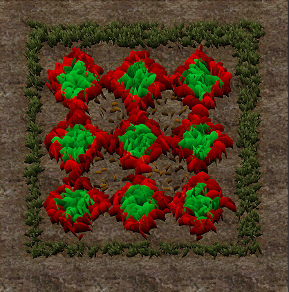

For example, we have the following diffuse and mask textures:
Diffuse texture
RBG and A channels of the mask
We see, that in the first column, chunks of the green shades correspond to the red channel of the mask, which is 9 red rhombuses; in the second column, chunks of the real grass variation correspond to the green channel of the mask, which is the square green mask frame; in the third column, chunks of the red shades correspond to the blue channel of the mask, which is the blue rhombuses frames; and in the fourth column, chunks of the yellow shades correspond to the alpha channel of the mask, which is the rest black areas (note that these parts won't re rendered, as there no alpha color data).
The result will be as follows:

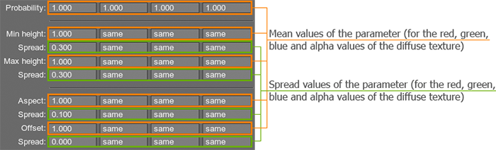

Randomizing Grass
To randomize appearance of the grass blades, two types of values are used:
  • Mean value (set in the main field of the parameter:Aspect, Minimum/Maximum Height, Offset) defines the average value of the distribution. Four fields correspond to the red, green, blue and alpha channels of the diffuse texture correspondingly. With its help the designer can set setting milestones to control the parameter.
  • Spread value defines the range for possible variation of the parameter. Four fields correspond to the red, green, blue and alpha channels of the diffuse texture correspondingly. The higher the value, the more diverse the final result will be.
    Spread value is optional: if set to 0, it will not influence the simulation process and only the mean value will be uniformly used.
Mean and spread values of the grass randomization parameters
Probability
The probability of appearance of the grass chunk belonging to the definite mask channel (horizontal row) depends on the Probability parameter. The variations of the specie (vertical column) will be rendered randomly.
Probability of appearance of the grass slots belonging to the red, green, blue and alpha channels of the mask correspondingly

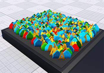

Num textures parameter sets how many horizontal rows with grass clusters, plants or flowers are presented in the diffuse texture. After specifying the number, each grass cluster is rendered as a separate quad on the field.
4 Texture Slots; Num textures = 1
8 Texture Slots; Num textures = 2

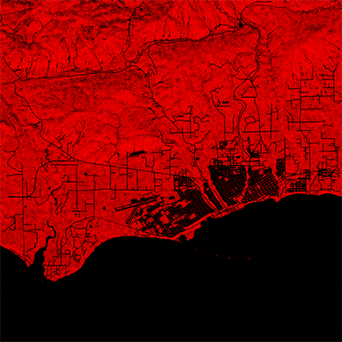

Image Mask for the Grass Field
To simulate the convincingly looking pasture that naturally blends with the rest of the virtual environment, the grass field can take an arbitrary outline gradually shaping and growing on the ground. Furthermore, the grass can grow chaotically and irregularly forming clumps of green and grassless patches, just like in the nature. Making this effect possible, the mask is mapped on the terrain and determines the density distribution that will meet the requirement of the created landscape.
The mask is an RGBA8 texture. Each channel of it controls the distribution of the grass per vertical column of grass diffuse texture (there can be up to 4 columns in the diffuse texture).
  • Red channel specifies the areas of growth for the 1st texture column. If there are several grass clusters in a vertical column, they will be randomly spread across the masked area.
  • Blue - for the 3rd texture column.
  • Alpha - for the 4th texture column.
For every channel separately, areas where the grass should not grow have 0 channel value (no color or alpha data). Non-zero channel value creates a grassy area: the higher the value, the denser the grass grows.

Minimum and Maximum Mask Values
As a solution for advanced objects seeding and memory consumption optimization not only a whole mask, but any required part of it can be applied to the object. It means that different multiple objects can share the same mask, but use different levels.
By default, each channel of the image mask specifies the areas and the density of growth in the [0;255] color density range. However, by using Min value and Max value, you can specify any color density range in this diapason and that part of the mask, which contains the specified density range, will be used to seed the grass.
For example, there is the following R8 image mask:
Several grass objects that represent grass of different heights can share this mask as follows:
  • In range from 100 to 200 density of the short grass can be stored. The part of the image mask, in which the specified range of color gradation is stored, will be applied for the short grass object.
  • In range from 160 to 230 density of the grass of the mean height can be stored.
  • In range from 190 to 255 density of the tall grass can be stored.
