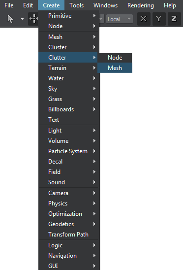

To create Mesh Clutter, simply perform the following steps:
  1. On the Menu bar, click Create -> Clutter -> Mesh.
  2. In the dialog window that opens, choose the path to the .mesh file. This mesh would be used as the source one for the clutter.
  3. Place the clutter object somewhere in the world.
  4. Specify the Mesh Clutter parameters.

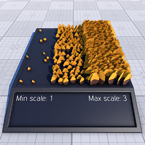

Min and Max Scale The scale mean value of scattered objects depends on the minimum and maximum scale mean values and the image mask values: the mask values are used for linear interpolation between the minimum and maximum scale values.
  • The mean scale value cannot be negative.
Min scale Sets the scale mean value for objects scattered in the areas with low density (according to the image mask). The higher the value, the bigger the objects will be in such areas.
When image mask is not set, this parameter isn't taken into account as the default mask stores only the maximum mask values (there are no areas with low density).
Max scale Sets the scale mean value for objects scattered in the areas with high density (according to the image mask). The higher the value, the bigger the objects will be in such areas.
For example, if the following image mask is used:
The clutter objects will be scaled as follows:
Min scale = 1; Max scale = 3
Min scale = 3; Max scale = 1

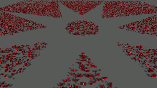

Besides scattering the meshes evenly across the whole area, a mask for their positioning can be used. It controls where the meshes should be placed.

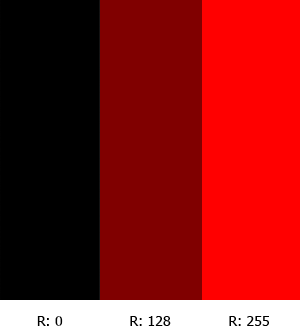

Image Mask Mask determines areas across which the objects are randomly scattered and areas where there will be no objects from the list. For example, on the terrain a mask allows to scatter stones across the rocky areas, while leaving the grassy ones free from rocks.
When the image mask is not set, the default mask with maximum mask values will be used. The maximum mask value is 255.
  • The mask is one-channel texture (R8). If there are more channels in the provided mask, they will be ignored.
    • Zero color value specify the areas without Clutter objects.
    • The higher the color value is, the more objects there are in this area and the denser they are positioned.
    • Color value of 255 means the density is as specified by the corresponding parameter.
  • Masking is done for all objects that are contained in the Clutter list.
