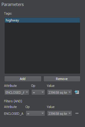

  4. Add tags for each type of spline objects you are going to generate by clicking Add and specifying a tag name.
  5. For each tag you can specify a set of filters (AND) to select certain data from the vector source. You can add as many filters as necessary. This can be done by selecting attributes from the list and specifying necessary values for each attribute. You can specify as many filters as you need.
    Use "+" (plus) button to add a filter, or "-" (minus) to remove one.
    If no filters are specified, all the data from the vector source will be used for generation.
  6. Now all necessary tags and filters are added and you can proceed to the next step.
