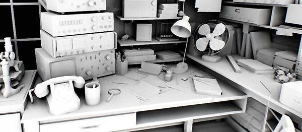

This section contains settings related to screen-space ambient occlusion (SSAO).
Ambient Occlusion Settings
Enabled Toggles SSAO on and off.
Preset Quality preset of SSAO.
  • Simple Low — simple low quality preset
  • Simple Medium — simple medium quality preset
  • Simple High — simple high quality preset
  • Simple Ultra — simple ultra quality preset
  • Raytracing — raytracing calculations for SSAO are enabled
  • Raytracing + Denoise — raytracing calculations along with the noise reduction for SSAO are enabled
  • Custom — adjust the feature's quality manually
