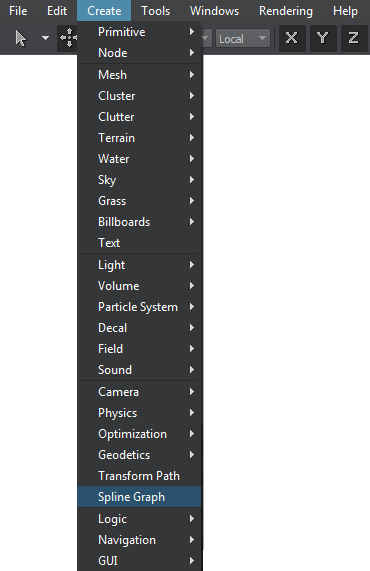

Creating a World Spline Graph#
To create a new world spline graph, do the following:
  2. Specify a name of existing spline file (*.spl) to be used for the new world spline graph or a new name to create your spline from scratch.
  3. Edit the spline graph by managing its points and segments.
  4. Assign desired source nodes to points and segments of the spline graph.
