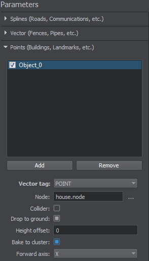

  1. On the Sources panel, select the Vector data source type and the following settings will be displayed in the Points tab of the Parameters panel.
  2. Add a basic object for generation by clicking Add button at the top of the Parameters panel and specify object's name. You can add as many objects as nesessary.
  3. For each basic object specify the following parameters:
    Vector tag The tag to be used for the selected basic object from the list of the tags specified at the second step.
    Node The path to the basic object's *.node file.
    Collider Flag indicating if collisions for the generated object are to be detected.
    Available only for geometry type.
    Drop to ground Flag indicating if the generated object will be aligned with the terrain surface.
    Bake to cluster Flag indicating if the generated objects will be baked to a MeshCluster.
    The option is available only when the specified *.node file contains a static mesh.
    Baking to a MeshCluster shouldn't be used for large areas because of the coordinates precision limitations.
    Height offset Distance from the terrain surface along the Z-axis, in units.
    If you see the generated object partially, You can try to increase this value to lift it above the terrain surface.
    Forward axis Axis which determines orientation of the basic object: X, -X, Y, -Y.
