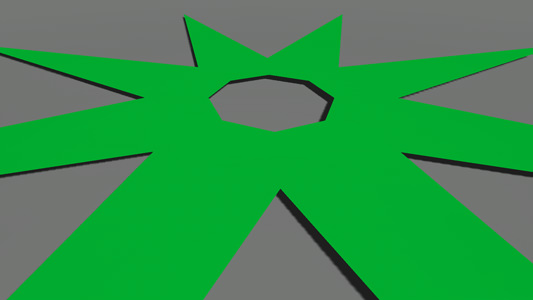

Mesh mask Mesh-based mask that is used to specify areas where grass can grow. A mesh for masking should be a simple planar mesh.
Mesh used as a mask
