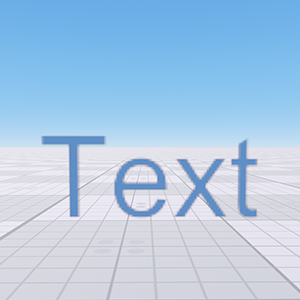

Text Object
A text object is an object representing a plain text in a 3D space. The text is rendered into a texture that is applied to a flat polygon. It uses trilinear filtering and mipmaps to correctly display the text at any distance. There is no noise influence to the object and it is not distorted by TAA.
The font can be represented as a TrueType font (TTF) or as a texture atlas with letters.
